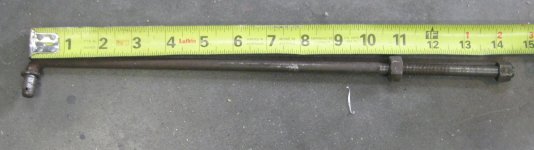

Hi, well I goofed up on the uploads, there are duplicates, but believe me, I am better in the garage than on the computer. Actually, it is a miracle I can do this good without any help! Good luck

Thank you akidwithacar, for that above Picture I can tell you that sure looks to be the correct 1965 Ford Mustang Equalizer Bar Ford Part #C5ZZ-7528-A on the far left since it has the Swivel Block on it for the Clutch Rod the first of 2 1966 Z Bars for those (built before 2/14/66) also will have that Swivel Block but the last 1966 Z Bar made for (for those built 2/14/66 and after) don't have that Swivel but the 6 Cylinder Z Bar is basically the same one other than that same difference. If I had the measurements from it I could make a new one or even convert a V8 Z Bar by lengthening the center section to the Six Cylinder Length they are a very simple part. I know all the Tube Length measurements of the various V8 Z Bar's but have not found out the measurement of those for the 170 & 200 Six roughly they are about 2 to 2 3/4 inches longer than some of the V8 Bars since the 170 & 200 Six engines setting in the chassis are that much narrower than were the 260 or 289 V8's. Yes I also found that too when I was searching for the 1965 Six Cylinder Z Bars Part #C5ZZ-7528-A, and the two 1966 200 Six Cylinder Z Bars Part #C6ZZ-7528-A, or Part #C6ZZ-7528-D Z Bar the Part Numbers are Right out of the Ford Parts Book. But for some reason the online search engines will change the last Letter so that only the V8 Z Bar's will come up after all they all use this same Basic Part # number except for the last letter will I.D. or is changed for the engine application. Edited to fix the Links!
