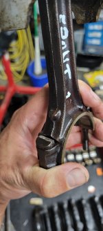

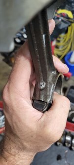

I'm putting together a 250 to race in Lemons. I blew up the last one due to some oil starvation issues.
I've got 2 different sets of rods I can use, one set has an oil squirter hole drilled at the big end and one does not.
The squirter points away from the cam, down the thrust side of the cylinder wall.
Seems like more oil into the cylinder wall on a race motor is a good thing?
The "no squirter" motor is a D5 block, and I'd read that the elimination of these squirters had to do with emissions stuff. Not relevant in my case.
So...any reason to use the non-squirter rods that came of out this block?

I have never had a problem with the rods breaking at the oil hole on a short stroke 200 but, the 300 people have had problems and the 250 has about the same stroke but a little lighter piston, so there is that.
After market rods do not have oil holes but I run at little more clearance on the rod and main bearings so I figure that there should be plenty of oil to cool and lube the piston. One day for my turbo 200 I would like to try piston oilers but not this go around.
As "drag-200stang" posted, the connecting rod big ends will flex at the oiling hole and eventually fatigue and break.
Does the connecting rod without the oiling hole still have the hole inside the bearing area as show by the lower rod or does it look like the upper rod in the picture below?
