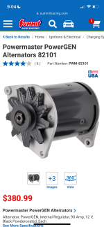

I’m looking into the generator to alternator conversion for my ‘60 falcon. I’d love to use the Powermaster generator “look-alike” (part number 82101-2)
Has anyone used one on our inline 6’s? Seems like theirs two part numbers that would bolt onto the Ford generator bracket, BUT… one does not have a terminal for the gen light, and the other does have a terminal for the gen light to work, but the terminals would be facing the engine, not away from the engine like it is now. I’d want to keep the dash light functioning. Thoughts?
I wanted to add that the response from Powermaster was pretty vague and not very helpful. I’d think theirs either one that’ll be a direct fit for an early Ford inline 6, or not.
First photo shows the one that allows the gen light to remain functional, but the terminals would face the engine.
Second photo (summit screenshot) shows the one without a terminal for the gen light.
Third is part numbers.

Hard to tell from the pictures if the end caps might be clockable? Meaning you could take out the end screws and carefully rotate 180 degrees and reinstall the screws. Maybe you could ask them that?
Yes, dito. Was going to suggest the same. Since the wires exit on the body not the end, it is possible it may be an easy clock to turn it around. This assumes the two thru bolts (out of sight on the pic) are symetrical with the two on this side, which is probable.
Maybe also noteworthy to check if the spin direction is the same on the powergen, because they are rated for v8's, do they turn the same direction? Basically the position of the connections should not really be an issue. You do not need the original connections from the harness anyway i believe, so you can fab you own longer wires and maybe also use more insulated or heat resistant wires?

If the body clocks without binding any wiring- which that one looks like it should- the five minute procedure is better than having wires facing the manifold regardless of heat shielding. BUT it can work as is with heat protection.
That’s a great question, if these are clock-able. I had just assumed since there was no mention of that in the description, and the response from Powermaster didn't mention it either, that it wasn’t. I shot Powermaster another email. I’ll let you guys know what they say. This would definitely solve the issue of the terminals facing the engine.
