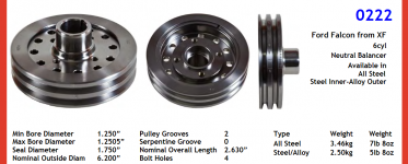

- Harmonic Balancer / Damper
- http://www.atiracing.com/contact/contactati.htm
- B-H-J - Spoke with Chris, good conversation
- Fluidamper contacted - nope
- ATI - too much normal stuff to do custom.
