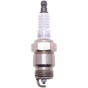

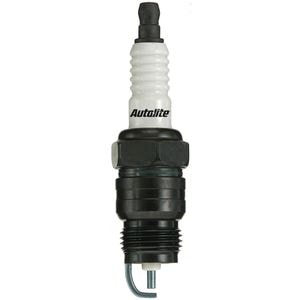

I was checking the plugs on my 92 F150 EFI 4.9 a while back and noticed the plugs have much longer electrodes that stick out in the chamber further. I remember reading in the F handbook about a preference for this extended type of plug over the oem Autolite 46 and 45 type but I could never find them. Are these the plugs? I know the N/A 300 oem plugs are 45's and are a step colder, but what rating are the 5125's by comparison? Is it still the last number, so they would be a heat range 5 like the 45's?
Should I use these plugs instead of the 45's I was going to use?
VS:
