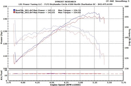

The 200ci engine is bored 40 over, with a dual pattern 264/274 Classic Inlines cam, modified D8 cylinder head, re-curved Duraspark/MSD ignition, high ratio rocker assembly, dual out Hooker headers, Flowmaster mufflers, and a custom built 4412 Holley 500cfm-2V carb with annular discharge.
