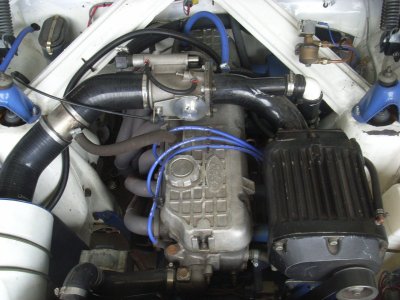

Yes, all true, just for your amusement, here is my 200 inline, around 250bhp
