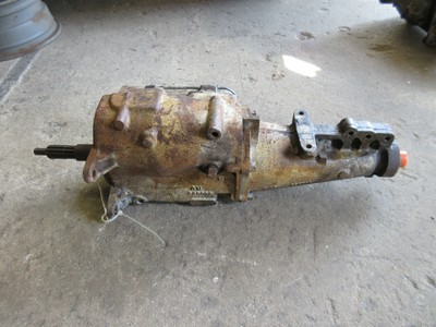

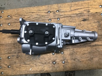

I just rescued an Argentina 221 SP Ford 6 that was about to be scrapped. It is a complete engine with aluminum spider style intake, Holley 2 barrel carb, and chrome Ford valve cover. It also has acastiron bellhousing and a 4 speed trans. That looks like a Saginaw(?). My question concerns the availability of parts: gaskets, seals, rings, bearings etc. And what if any parts will cross over from the 200 or 250 engines. Thanks for any help! Cliff.

Thankyou for the valuable info. on the 221 SP. I was not at all familiar with this particular engine and was intrigued when I looked it up. I've always been a 240/ 300 guy and have several of those set up for dragracing. I'll take some pics. Of the 221SP and transmission and get them on here. I'm thinking it may find a home in my '52 Anglia. :)
