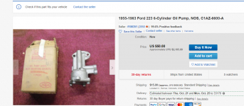

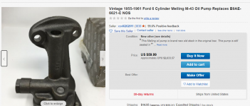

Can you please tell me, why these oil pumps are indicated for the same years, but looks differents? A friend of mine, who has a 58 custom with the 6 cyl, has a oil pump that looks like the first one of the photos attached... My mechanic is going to take out mine, to compare with this pictures... But in the meanwhile, can you tell me why are this oil pumps different, and if they are interchangeable?

The first picture is a Melling M-43 this is an aftermarket oil pump it is made of cast iron and is the right Oil Pump for 1955 to 1960 Ford car and truck 223 sixes but its add is incorrectly labeled as to all the years it fits. The second oil pump looks different because its an OEM Ford oil Pump and is made of Aluminum. I can't tell what the box'es part number is in the picture, but If the pump has a C1AE part number stamped on it that would make it the wrong oil pump, but the add label also can't be right then, according to Melling it wouldn't be right for both a 1955 to 1960 223 engines as well as the 1961 to 1963 engines. Your friends 1958 Ford 223 though would use the exact same oil pump as yours.

The first picture is a M-43 this is an aftermarket oil pump it is made of cast iron and is the right Oil Pump for 1955 to 1960 Ford car and truck 223 sixes but its add is incorrectly labeled as to all the years it fits. The second oil pump looks different because its an OEM Ford oil Pump and is made of Aluminum. I cant tell what the box part number is. If the pump has a C1AE part number stamped on it that would make it the wrong oil pump, but the adds label cant be right then, according to Melling it wouldn't be right for both the 1955 to 1960 223 engines as well as the 1961 to 1963 engines. Your friends 1958 Ford 223 though would use the exact same oil pump as yours.

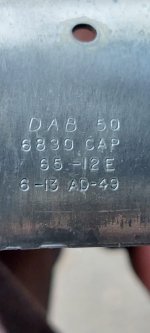

In a local store, they have measured my connecting rod bearings, and the size is .010. But my connecting rod bearing have this inscription "DAB 50 6830 CAP 65-12E 6-13 AD-49" as shows the picture attached to this post. Do you know if this inscription means anything related to the size...? Someone over facebook told me that is something related to the date, but I want to be really sure, because I am buying this things online, and they will be shipped to my country, so no refunds....

Yes those on that side of the bearing are the manufacturing numbers and date codes. The bearing size is located on the other end (on the opposite side) of the bearing shell. If you have those or a picture of them I can ID the bearing size exactly. Good luck

Hi Ignacio223UY, it's not a bother I am glad to try and be of some help you. Some bearing manufactures had their own numbering system to tell the bearing sizes but with some Genuine Ford bearings they would not be marked for the Standard size these had an oval shape with a FoMoCo stamped into it these were Standard, they also had a .0001 or .0002 bearings that were sometimes used to get the oil clearance correct. Those DAB bearings were also an OEM Ford part, without a clear size marking on the bearings than the best way is to measure the Rod or Main bearing journals on your crankshaft and then you will know what the true size is.
