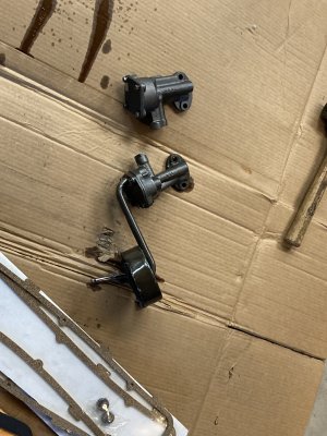

I did this swap and quickly found out that the oil pump pickup tube is different, and pretty hard to find too. The 64 oil pump draws from the side, the others draw from the bottom. I was also concerned about snapping that little chinesium shaft. However, I’ve beaten the heck out of those little adapters with my Milwaukee cordless impact gun and I’ve never broken one. I only decided to do the oil pump swap because I wanted to run 20/50w to try and quiet down those solid lifters a bit, which didn’t work lol.

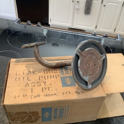

The pickup tube I used is Ford part # C1AE-6622-A. These are rare and expensive so if you can modify your original then I would consider it.
I used a Melling M67A pump which is readily available and not expensive. They do bolt right up with no issues. You need to use the correct shoulder bolts or the pump may not stay aligned with the distributor. Remember to use some anaerobic sealant on the bolts.
The proper oil pump driveshaft is Melling IS67A. It is a few thousandths undersized from a typical Allen key, not sure about the hex drive tool but that’s something to consider. Some engineer made that call for a reason.
Good luck

For anyone wanting to do the 300 distributor swap with the 61-64 223 oil pump, there is an oil pump pickup tube on eBay for a reasonable price. It’s got some surface rust but should clean up nicely with a bath in Evaporust.
#C1AE-6622-A
