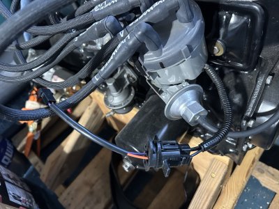

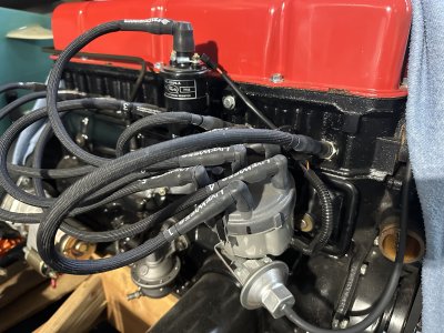

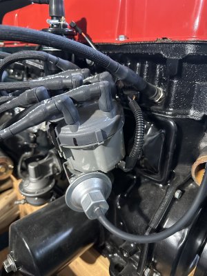

I don’t have a part number for the oil pump pick up tube but I do have the melling intermediate shaft part number for the 67A pump to duraspark dist if you need it. Not the greatest pics but here’s my dist. I used dui spark plug wires as well.

@Paps61 Wow those wires are impressive, thanks for replying. I know I am being a bit picky but I did manage to find a Cardone reman (30-2610) and an old Ford reman 300, both have the small cap, points style. I’ll work on finding the pickup tube or I’ll modify mine this week. I did find the hex shaft, someone posted a link with the part number which was really helpful. Thanks again

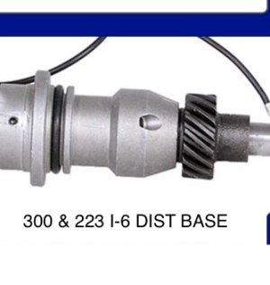

The small cap (points style) distributor is hard to find/ out of production. Nobody has them.
(Edit; Rock Auto has the Autospark D446 which might just work!)

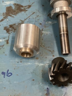

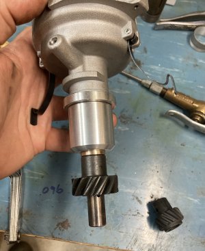

There is one on eBay now but it’s not cheap. I searched for a long time and finally found one, then I was lucky enough to find a spare. I don’t know about the Duraspark but those have a larger diameter cap, looks different and takes up valuable space. The 300 points dizzy uses the same small cap as the 223 (and I think different rotor.) The unit I’m running currently is actually a Falcon/ Mustang style and I added a cup & bushing to it and just made it fit. Not recommended but it works great.
The Cardone 84-2610 (new) and the 30-2610 (reman) are out of production. Nowhere to be found. I ordered a few from vendors and eBay and all of them were incorrect so I sent them back.
Here’s what I used;
Pickup tube is C1AE-6622-A
(Not cheap)
Oil pump Melling M67A
(5/16” hex)
Oil Pump drive shaft
Sealed Power 224-61117
(5/16” hex)
Distributor Gear B5A-12390-A
Distributor WAI DST2613 (Falcon/Mustang style,
not recommended)
