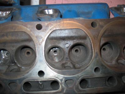

Lookin good!!! :wink:
Now look at the bottom of the bowls in these 2 pics,
See the ridge that runs around the bowl??
Make that go away, and smooth it all up :D :D
One other thing....Have you gave any thoughts about installing the later 1.75" intake valves?? Your machinist can cut the seats bigger so they fit. Mine did that as part of the 3 angle valve job. Just order valves for a 1980 head. I think mine cost $30.00 for all 6 valves.

I'm not sure which ridge you are talking about. Are you talking about the ridge on the exhaust side of the bowl? I'm just unclear on which one you are talking about.
