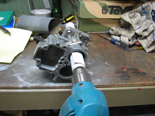

Or a stock 5200 Holley Weber, which can be routed out to 29 and 31 mm venturis and still work, as well as flow 336 cfm like this one by Mercury Marc(an Aussie told him how to do it!)
