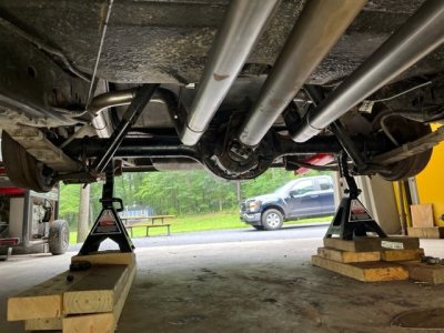

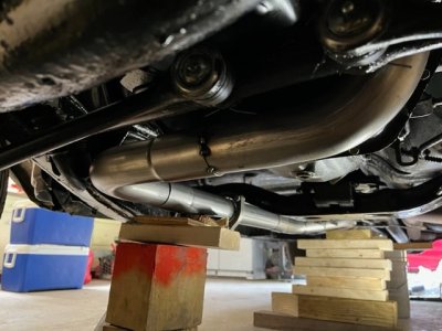

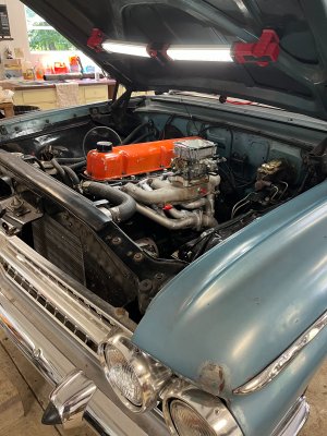

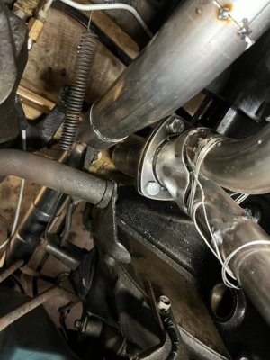

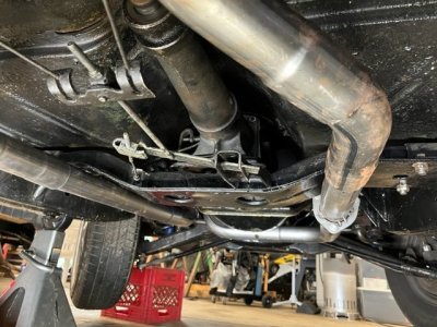

I never liked the way that header had to be routed. Actually I have Clifford header in my car. It actually came from a used engine from a pickup. I cut it apart and routed the crossover under the engine. Here are photos of my setup. Some of the photos are from when I was in process of welding it up. It is a tight fit around the transmission linkage and the z-bar, but it can be done.

I will get you a good photo of the completed header so you can see the complete finished product, if you want to tackle some fab work yourself. Also I used 2.25 for the exhaust pipes.
