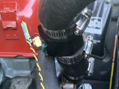

It has a threaded bolt in the collar that grounds to the chassis. If I take the spade connector that connects to the output of the sensor and place it on the sensor housing, the fan turns on so the circuit is good but the sensor isn’t.
