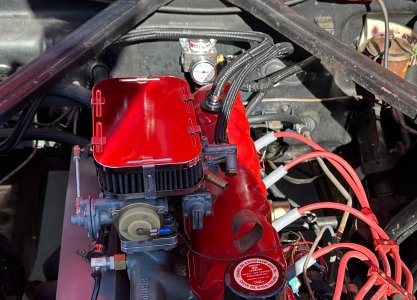

I take this back... My fuel pressure was too low. I finally got around to putting in the Fuel Pressure Gauge and saw that my fuel pressure regulator that was precision adjusted for the Weber 38/38 was pretty much running the absolute minimum it can run. The adjuster was backed all the way out and it was probably registering about 1.5 lbs of fuel. I adjusted it to 3 lbs and took it for a good spin. No lack of power. Pulls to redline in at least the first 3 of 5 gears going uphill and jumps when you floor it anywhere past 1800 RPM.
Idle has a little bit of a wiggle to it but off idle it pulls hard and smooth with a 38/38 on an adapter the small log. I can only expect it gets better with a direct mount on the large log.

That's Awesome! Fuel gremlins seem to pop up out of nowhere I've found.
