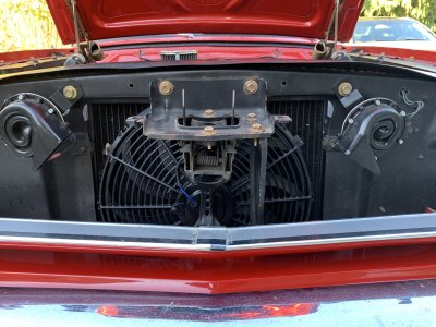

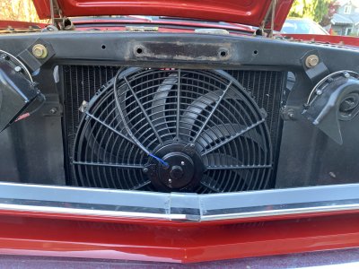

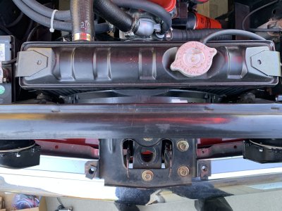

One thing I did this weekend was mess about with the electric fan. The fan I have is just under 3” deep at the motor and it’s too deep to go on the engine side, unless I move the rad farther forwards towards the grill about an inch AND it’s too deep to go on the grill side without moving the rad farther back, towards the engine by about a half inch. Well, one thing lead to another and before you know it, I had the grill off and the hood release mechanism off and I’m moving the radiator back towards the engine a half inch.
I haven’t wired in he temp sensor yet and I’m adding a manual override toggle under the dash so if I need a little extra cooling, I can add it on demand. I mounted the radiator on rubber bushings I had left over from the shocks I replaced a while back. They were the perfect size.
Nice! It's said a pusher is more efficient than a puller. . . One thing, with the gap now present between the rad and support, there is reduced effective airflow thru the rad area not under the fan shroud. . The gap affects airflow patterns under the hood too. (Not that most folks give that much thought, but we're not most folks). . I know this from moving the rad back in a truck, cooling efficiency went down and partially offset the effectiveness of the electric fan. Sealing the perimeter restored cooling efficiency. (My el. fan covers a smaller radiator area than yours.)
Perhaps your next weekend project: seal the gap around the radiator. :cool:
if you can just move radiator without collateral issues it sounds simplest.
... the '74 Maverick , the radiator needed to be moved forward to clear SC drives. The stamped steel Grill / hood latch support is cut down and angle iron welded to re-enforce. The late Mustang radiator has sides filled but notice OEM battery area venting.
I had installed a big puller elec fan but oddly the good old WP fan seems better handling temps under boost, maybe the slower reaction of sensor vs constant WP fan when engine is at boost RPM's (?).
Yes, I think I'll have to come up with a gasket to fill in the gap. I've still got to make my tin heat deflector for the header too.

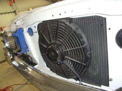

Just for edification:- This is a 400mm Australian made fan, it draws 16A running and 30A starting, I have a 130A alternator which is able to cover this at idle. the fan is cable tied to the radiator tubes. this works in Australia climate on the east coast, i have a blown 3.3 litre six with a two row v8 rad. I manually control it via a relay.RIMG0310.JPG
Just for edification:- This is a 400mm Australian made fan, it draws 16A running and 30A starting, I have a 130A alternator which is able to cover this at idle. the fan is cable tied to the radiator tubes. this works in Australia climate on the east coast, i have a blown 3.3 litre six with a two row v8 rad. I manually control it via a relay.View attachment 27573
That is very similar to the one I put in. Mine is 400mm and draws about 13amps when it’s running. I’m not sure what the startup current is but my charging system doesn’t seem to mind even with the halogen headlamps on, at idle. It’s rated for 2600 CFM which is plenty. I have run it on a hot day and it cooled the radiator better than the stock fan. I’ve got it wired to a relay with a manual toggle under the dash. I’ll put in the temperature sensor once I get the hose coupler. That should be here later this week.

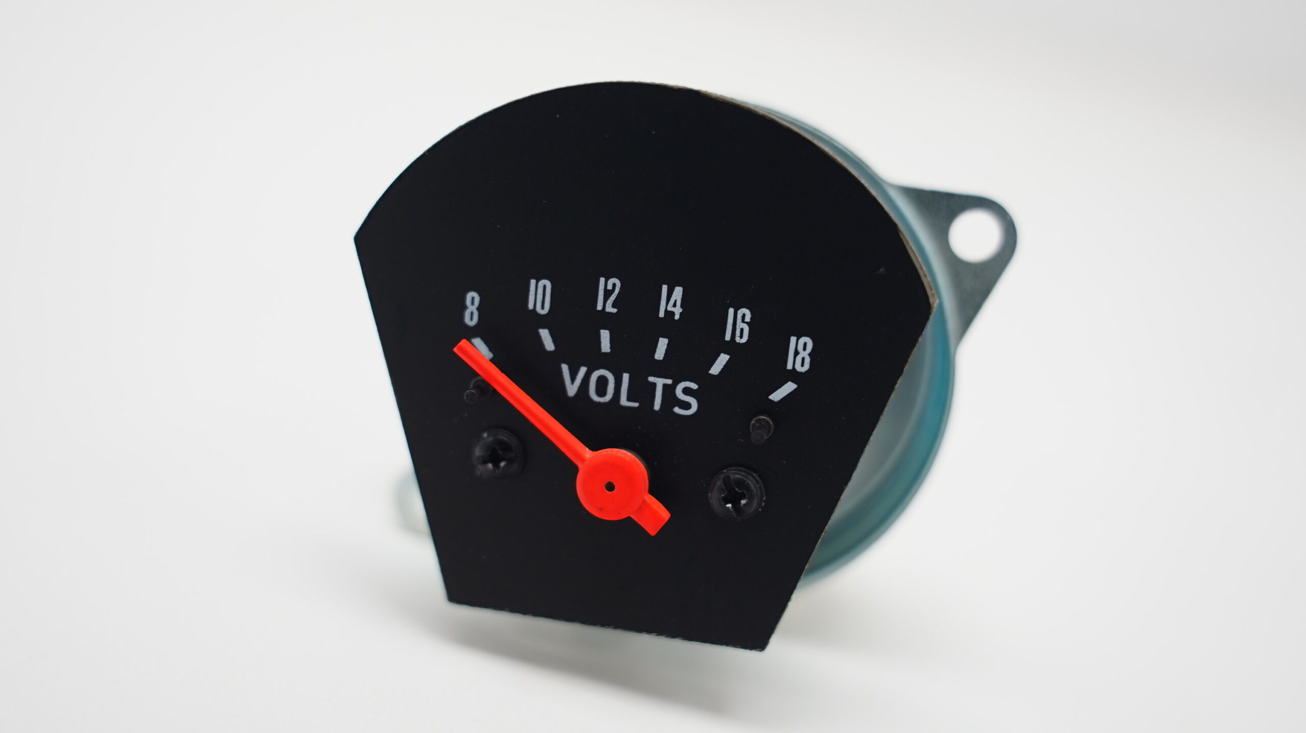

My dash currently has an ammeter but will get this voltmeter:

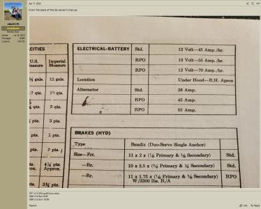

chad, perhaps the '66 bronk was different, stock alternators of that era were lucky to have 45 amps. The generators these replaced were 25 amp.
Yes that is correct. I never confirmed I had a 60 amp alt just guessed at it most likely or possibly upgraded the amp somewhere along the line as I have owned my 66 since the mid 80s and I forget a lot of things.

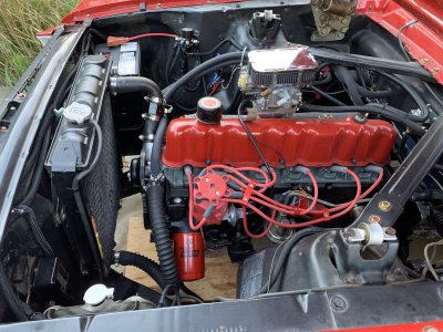

Well, I removed the 6 blade belt driven fan from my car and am just using the pusher fan. It’s a lot quieter without the mechanical fan. Like a lot. It’s smoother too. It’s noticeably smoother when it’s cold and warming up. I think my stock 6 blade fan is poorly balanced and that come through when the engine is cold. That’s just a hunch. I haven’t checked the balance out.
I was out for about an hour driving around with mostly the electric fan off. I was just driving around town in fairly decent traffic. Heavy enough but not stop and go, rush hour traffic. Lots of traffic lights and slow traffic but it performed great. It’s mid October and that means the air is pretty cool and dense. It would be better with a fresh cold air intake, through the firewall but it was pretty ok without and the phenolic spacer between the carb and intake keeps the carb from getting hot. It’s cool to the touch. Not cold, just not warm.
At about 45 minutes in, I was stuck behind half a dozen cars at a stop sign controlled entrance to a busy street and the temp climbed up to about 3/4 on the temp gauge so I switched it on with my manual override switch. It cooled down pretty quick and there were no issues.

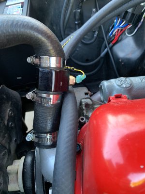

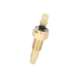

My temp sensor (Amazon) doesn’t seem to be working. It’s a 1/8” NPT 200 degree switch and it is supposed to switch closed at 200 degrees and turn off at 185 degrees. I’ve got the housing grounded and the other side goes to the relay coil with +12v on the other side. I’ve checked and the sensor housing is seeing ground. The issue is that the sensor shows me about 85 ohms to ground when it’s just sitting and when it’s getting hot coolant, it’s open. I’ll reach out to the vendor to get a replacement. Fortunately, I wired in an override toggle under the dash that switches ground to the relay so I can switch it on as needed.

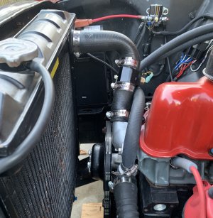

I'm having a hard time finding a good 1/8" NPT (200 Degree on 185 Degree Off) rad hose temperature switch. The one I installed earlier this week didn't work. The relay for the fan triggers if the sensor output is grounded to its case so my circuit it does indeed work but the sensor was defective so I ordered another. The new one is the same. Does anyone know a good source for a decent thermal switch? The only requirement is that it's a 1/8" NPT because the sleeve I'm using on the radiator top hose is pretty small.
Fortunately I can toggle the override switch under the dash and as long as the engine is running, so is the fan. It keeps it cooler than the mechanical one did too. If it's running full time (cooler weather because of the fall), my temp gauge sits at between 1/3 and 1/2.
The little sensor that doesn't work, looks like this
On my car, it looks like this
How does it ground, being in the rubber hose?
