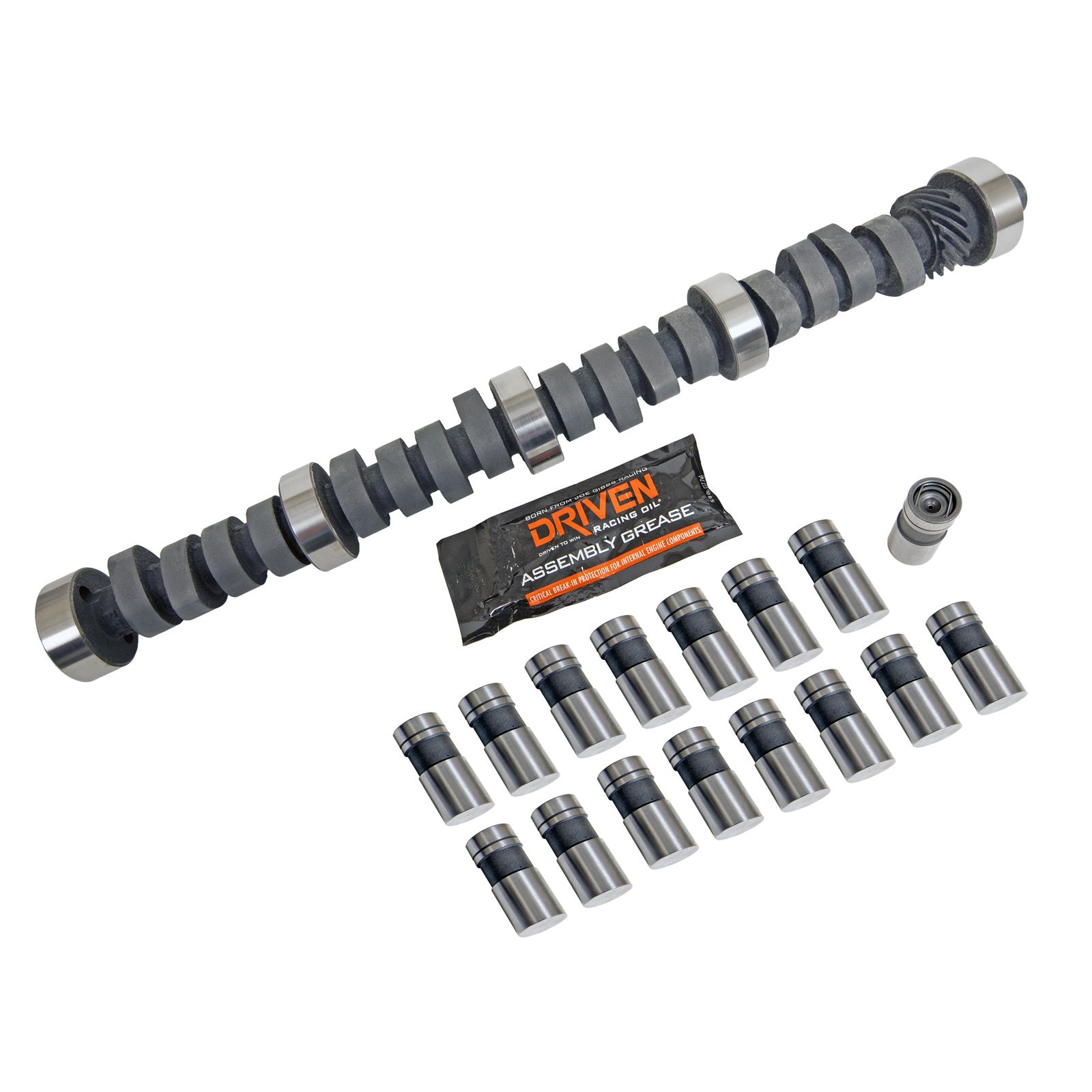

This is the Camshaft that I am considering
I built a 200 a couple of years ago with a Clay Smith camshaft (H-6474-0-B). You will have to get the double roller adjustable timing chain and gear set and you will have to degree it correctly with a degree wheel and dial indicator.
