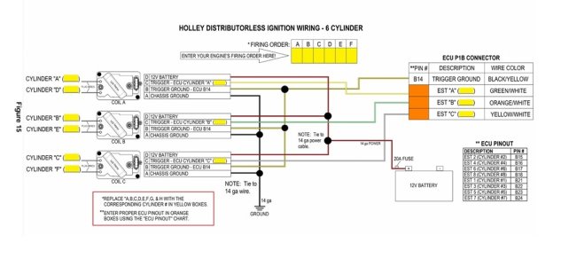

These coils are everywhere in the wrecking yards here in Canada. My dilemma with a weak Canadian dollar, any aftermarket coil x6 adds up when buying in American dollars. I'm lucky enough to have two PCM's on hand. One is an original flavour MS3Pro and the other a Holley Terminator X Universal. This Holley system is what I'd like to use if possible....thing is I called Holley to ask about ignition options and they more or less cater to the LS crowd and they have never heard of the D599A. That means stock LS coils/IGN1a or a slew of other smart coil types. That's where my interest is in this D599A coil is peaking my interest. It's incredibly easy to swap under hood and is dirt cheap new or used (and I have one). Where it's going is on a GM Vortec 4200 inline 6 with either PCM's. Both do 58x and smart coils in wasted spark. Hating to be the first to try....is there any good reason the Terminator X not work with a D599A being that it runs other GM smart coils?

Supposedly the Terminator X can be configured to run wasted spark smart coils for a six cylinder engine.
This is from the Holley HP instructions page 25.
The Terminator X should have this same pinout from the ECU.
It looks like you may be able to configure the Terminator X using the "Ignition Type" drop down menu and then select "Custom"
There should be an "Output Setup" under "Custom".
Let me know what you find.
