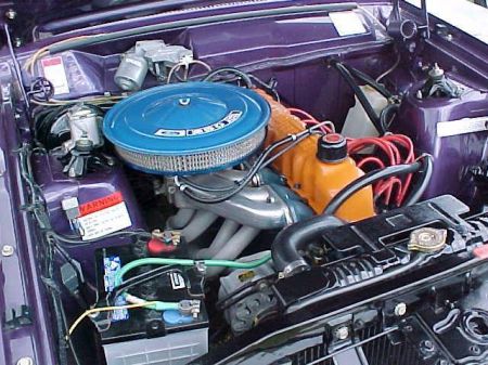

The Australian 250 2v had a  carb spaced 3.5" further out, so it used a special very shallow 11" diameter air cleaner assembley
The common 17" 302C 2V and 351C 4v lid  (same as the 5.0HO GT  4V) just fits in the Falcon engine bay, the 17" housing, does not.

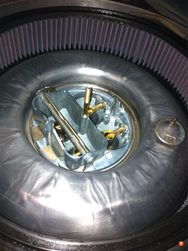

			I used this to make a custom cold air system for my car.  I built a new engine with a taller intake manifold and this no longer fits under the hood so I need to sell it.  I can sell just the air cleaner or with the hoses too if someone is interested.  The hoses are 4" ID hose and the attachment to the air cleaner was fabricated out of sheet metal and is no longer stock.  The emissions connections were all welded shut as well and painted gloss black with a polished lid and a new decal.  I have a spare decal i'll include with the sale.  It also comes with a K&N filter element.  It is not 100% perfect but it worked great on my holley carb.  It may have a few nicks and scratches from being in storage.  I would like to get $100 for just the air cleaner itself, plus shipping.  Located in Fredericksburg.
