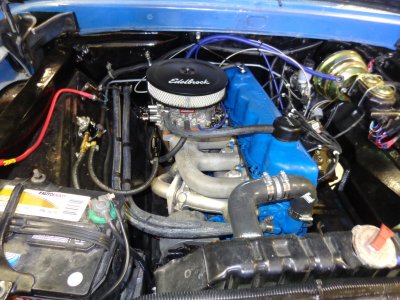

I use stainless steel studs and nuts. (zoom in) (Mc Master carr)
This is on my 300, same on my 144 falcon.
I am a huge fan of studs. They allow for total thread engagement and do not break when removing the nuts. All my heads and main caps use studs. I used stage 8 bolts on my 302 in a mustang and will never use them again. Why - Getting the locking tabs off was a nightmare.
I'm on the same team. I piecemealed mine out of studs, zink plated washers, lock washers and nuts and it cost a bunch. Next time I'll just get a small block ford or small block chevy kit.
