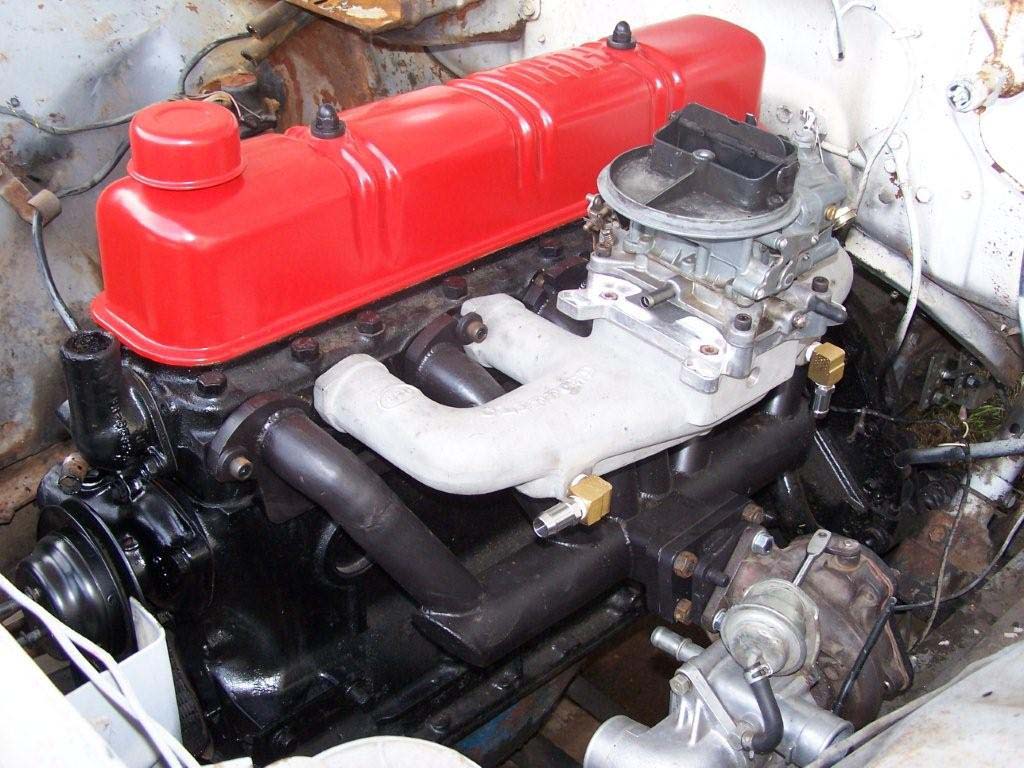

My son Neil is restoring a 1959 F100 with an inline 223 six, well I gave him a small IHI turbo that I picked up years ago for about $40.00 he got a used (never used $175.00) 4V clifford intake, and made his own turbo header exhaust for about $100.00, ebay turbo flanges about $30.00 and a Holley 500 2v from my old Supercharged mustang, he hasn't fired it up yet but will be adding MSD and few other things. The whole engine hop up should come in at under $500.00
That’s my motor. I fabricated the entire header then TIG weld it together. It took about 15 hours to Fab and about 1.5 hours to finish TIG welding it. I have some plumbing to finish up, but I will keep everyone post on my progress. If you have any questions let me know. And as for welding skills pratice, pratice, and mor practice.
