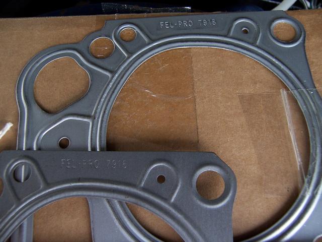

The only way to get it where I want it looks like I need a FOMOCO gasket with a crush and bore of .024" and 3.75", respectively. With that gasket it gets me to 9.246, but I still have to shave the head to 50cc. Which I can live with. With this setup and my Schneider 256H cam, I'll have a 8.39 DCR. I think this will be alright with 92 octane, but what do you all think? Is 8.39 too high for a DD on 92 octane without worrying about heating issues or anything? If I change the chamber to 52cc, it puts me in the 9:1 SCR and 8.17 DCR. What is my best choice here?
I guess my final question now is, does anyone know of where I can get or have an old 200 FOMOCO gasket?
