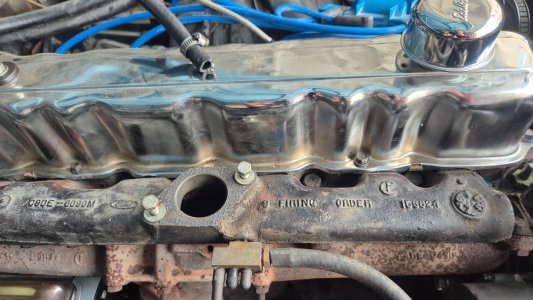

I think I have a 240 falcon engine from 69 in my 65 coupe body. From a little more in depth research I believe I need a carter YF carb however this presents an issue again with a spacer. I'm trying to locate the correct spacer and then get it shipped to Scotland. Not an easy task so far. Any suggestions welcome folks. And appreciate all the help so far

A 240 would require substantial mods to fit it in the engine bay. That’s probably a 200. A 250, installed correctly would need 250 engine mounts or modded engine mounts and the starter would be mounted low.
Is that C8DE or C9DE? It looks like an 8 to me and that looks like a small log 200 head. What size is that carb opening? If it’s a small log, it’s 1.5”, 1.75” if it’s the larger one.
EDIT: That’s bigger than a small log head. I think it’s a 200 head from 68 though. How many bolts hold on the water pump? Three for the 200 and 4 for the 250.

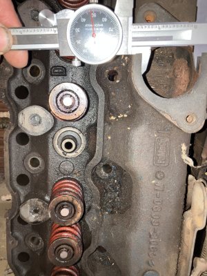

Same casting #(C9DE-6090M) cylinder head that was on my 1970 1/2 Falcon. 250 CID. 1 3/4” throttle bore.
Ford writing vs FOMOCO is different.

Yep, I stand corrected, that is a C9. Sorry to throw my misinformed opinion into the mix.
The bottom line is that the Vintage Inlines adapter will solve the problem. I can’t find anyone aside from Vintage Inlines who carries it though.
