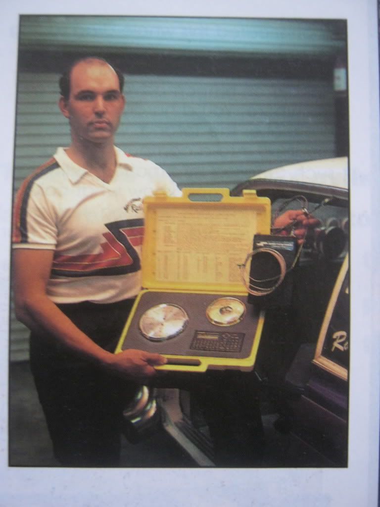

Best system for the buck was the 1986-1996 Cygnus-1 computer system, used to stunning success by Peter and John Sammut from Sammut Performance Products, Melbourne Australia. http://www.prosportengineering.com/cygnus.php.
I'm a civil engineering technican, Peter Sammut is a civil engineer, and his system is one of the best for the money there is.
In 1990, their 182 cubic inch Nissan RB30e powered Holden Torana Turbo did 620 hp with just a couple of turbos (9.2 sec 1/4s at 148 mph), and by 2004, their 182 cid inline RB30E powered 300ZX was doing 7 second quarter miles.http://www.calaisturbo.com.au/archive/i ... 85399.html

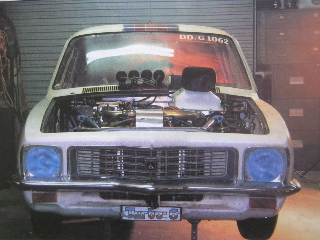

See the following from a 1990 Australian Street Machine Tough 6's magazine
http://i1215.photobucket.com/albums/cc5 ... G_5226.jpg
http://i1215.photobucket.com/albums/cc5 ... G_5227.jpg
http://i1215.photobucket.com/albums/cc5 ... G_5228.jpg
http://i1215.photobucket.com/albums/cc5 ... G_5229.jpg
http://i1215.photobucket.com/albums/cc5 ... G_5230.jpg
http://i1215.photobucket.com/albums/cc5 ... G_5231.jpg
http://i1215.photobucket.com/albums/cc5 ... G_5234.jpg
http://i1215.photobucket.com/albums/cc5 ... G_5235.jpg
http://i1215.photobucket.com/albums/cc5 ... G_5236.jpg

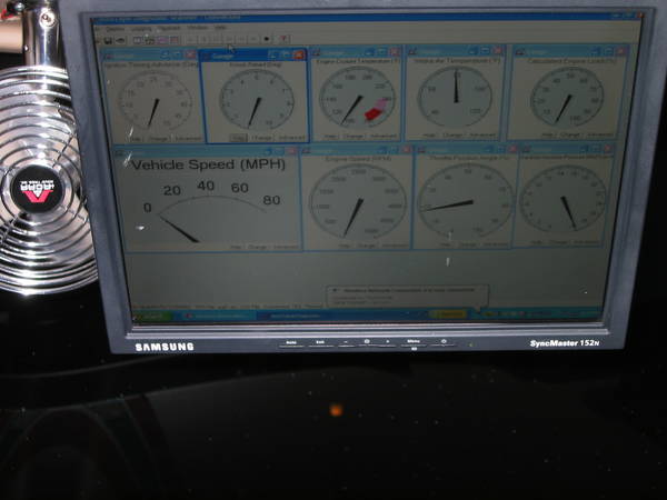

The standard outputs are many, but here for 100 ping are just a few....
http://www.obd-2.com/gauge1.gif
http://www.irv2.com/photopost/data/516/ ... 2_Scan.jpg
