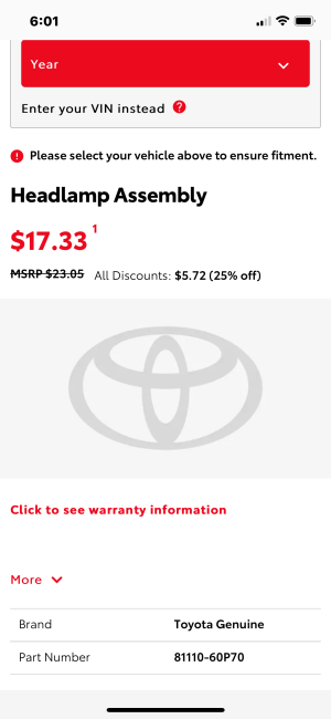

I got a set of these, from a Toyota dealer, haven’t installed yet but couldn’t pass up for the price👍. They aren’t led, but you can get led bulbs for them😎
Edit: it does come with two bulbs

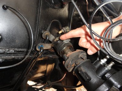

Also it sticks going from 1st to 2nd if you don't just let it fall where it wants to. Wondering if anybody has any ideas about that problem.
Yes. I'm assuming 3 speed column shift. Under the hood where the shift tangs come out of the steering column and attach to the shift levers to the trans: That area gets dirty and gummed up over time.
The manual column-shift is complex mechanically - or maybe "busy" would be a better description- compared to floor shift. There are 3 separate pieces to the steering column. 1) The outer fixed housing, 2) a smaller hollow full-length tube which controls shifts, with the necessary hardware on each end. There are 5 precise-moving parts with their associated nylon bushings and bearings controlled by the shift tube, between the shifter lever in the cab and the rods which move the trans levers. This tube has to rotate up/down AND slide forward and backward inside the outer housing. 3) Inside of that is the solid 3/4" rod which steers the truck.
The shift tube is spring loaded at the base of the outer housing, which pushes it up the column toward the cab, for the purpose of holding the shift lever in the cab to the 2nd/3rd side of the neutral gate. Makes shifting first-to-second more of a straight line motion, as this spring pushes the lever toward second gear as it comes into neutral coming out of first. The driver's motion is mostly straight up, not up-push-up.
When it gets dirty/sticky this spring assist becomes gradually more and more ineffective. The unfortunate side affect of this is that it's rarely corrected, most (all) drivers just keep using the "straight up" motion 1st to 2nd, and since the shift tube is not fully extended into the 2nd/3rd gate, the mating edges of the levers and pilot guide which define which gear is being selected get worn down with the years of imprecise shifts. Eventually the lever begins to hang up because of the wear.
Sorry for the long explanation. Part of the point of it is that you do not want to have to tear into it and replace these parts if possible. The whole column has to be removed from the vehicle, and then dismantled, and reassembly has to be precise, each piece in order and facing the right direction. Went through this early this year, and don't want to have to do it again.
SO-
Clean and lube with the goal of restoring correct travel of the spring across the neutral gate, which should eliminate shifter-hang between gears. It may not eliminate it completely, depends on how worn the parts already are. The goal of what's below is mostly to free the spring action of the tube. This is judged in the cab in neutral. The lever should be at rest away from the driver, aligned with going into 2nd/3rd gear. Pulling the lever forward and letting it spring back in neutral during and after the lubing should get it to where it snaps back to the 2nd/3rd gate cleanly and firmly. . All the area that's exposed from inside the column- clean it with brake clean. (see pic). It helps to have someone assist by shifting thru the gears and work the neutral gate back/forth while cleaning, to get as much grime off as possible. If you've got compressed air, hit it with that too. Can't hurt anything with the spray or air. Then use WD40 with the straw, and oil it up good. Hit everything you can reach, will not hurt anything from excess oil.
Careful oiling of the lever fulcrum in the cab also, if the lever shows signs of friction.
Wow this got long- sorry again. It's easier in person than with words only, LOL.
Last thing: there are 2 bushings, one on each lever where the shift rod to the trans connects. If they're sloppy replace them also. Dennis Carpenter is where I got my parts. Once all this is done, if it still wants to hang when crossing the neutral gate, adjusting the linkage will be needed. TBD after cleaning and bushings.
