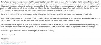

OK now this shows the casting id for the 69-74 250 head as C90E-M 1.75" bore only. Yet the Head ID page you provided states that C9DE-C,F,J,K head casting id for 1969, all engines including 250 is 1.5" bore. Not sure what to make of all this.

"In 1969 the factory made a running change in the cylinder heads. The carb bore was increased from 1.5" to 1.75".
C9DE-6090-C,F,J, and K casting numbers are the smaller 1.50" carb bore. The C9DE-6090-M has the 1.75" throttle bore and a flat-topped log manifold."
The Ford Falcon Six Cylinder Handbook page 7 Cylinder Heads
