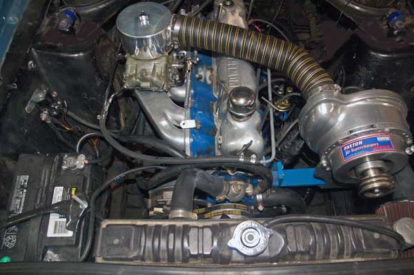

Mustangaroo":xlvp27dt said:
The above picture is the Paxton SN/89 mounted on the passagers side of my 1968 Mustang, I've had this setup for about five years, I had to relocate the battery to the trunk for the above installation. I am currently working on a drivers side install using the power steering mount. Sorry the engine bay is so dirty but this has been a daily driver for almost five years, I recently got a new H3 Hummer to replace the Mustang as my daily driver, hence I now can try something new.

The Paxton SN 89 is a good unit for a nice 312 with 4-bbl, or a Fox 5.0, but that Mc Culloch based unit is old and needs an armload of follow-up to make it reliable. It spins to create mid to high end power, so its okay on an I6, but its not like a typical rootes supercharged engine.
These days, Paxton make all the pulleys and new centrifugal Innova superchargers under the Paxton brand...such an amazing kit, but they don't make off idle grunt like the even the basic M62's and M90's.
