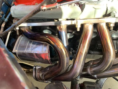

I believe that my headers from Vintage Inlines are the same design. I loosened the full-size starter and got them on using the proper swear words and some fiddling. A mini starter wasn't needed on my '66 Mustang.
I put one on my 66 Mustang as well with no need to change the starter or do anything with the alternator bracket. I did buy An Amazon heat shield blanket for the starter though. It’s fabric and has a foil side that provides some heat protection for the starter. I put it in with the engine so not swear words were required.

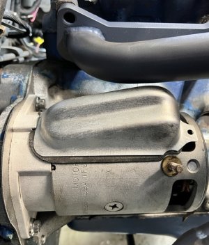

I actually got time to test fit the stock starter with the eBay header today. The good news is that it doesn't hit. The bad news is that there is maybe 3/16" clearance between the closest tube and the plunger cover. The cover is removable, and there is some clearance between it and the plunger inside, so I'm going to do a little persuading on the cover with a body hammer. Even with a little modification, it looks like a starter shield would directly contact the header. I moved the phone up and down and took this photo when the space between the two looked the largest:

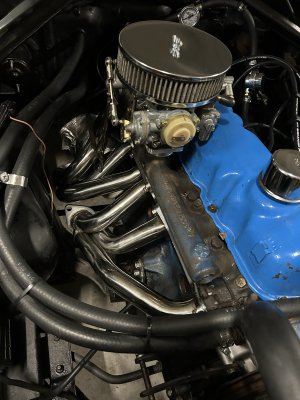

IMG_1743.jpegI can’t say for sure but my EBay header looks like it’s got a different bend to that pipe. Mine looks like it might be bent higher and more perpendicular across the starter before if does the carrousel-like bend down toward the collector.
