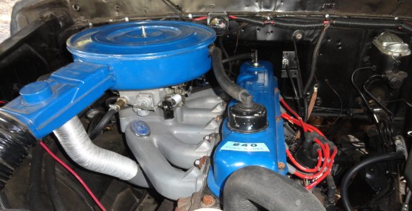

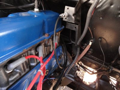

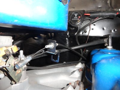

I used an Amazon cable and carb bracket when I converted a 240 to aftermarket intake/carb. A "cut to fit" version. They are very flexible and there is a good amount of adjustability built into each end to assure full throttle travel. It's routed behind the engine and has worked well for several months so far. Fabricated the throttle return spring from scrap, minor mods to the factory firewall bracket to attach the a'market cable from it to the carb. Stock from the firewall bracket to the pedal.
EDIT: the return springs can be run to the back bracket, it's not necessary to add on in front. I routed the springs forward to balance the torque applied to the throttle shaft.

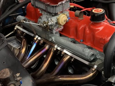

I put the Clifford/Redline Weber 38/38 carb on mine. It is a 2V carb where both barrels open at the same time. The kit came with the intake adapter which is like a funnel that reduces the 2v opening to a smaller diameter to mate with the intake. It is almost bolt and go. I changed my idle jets and adjusted the idle mixture and it’s pretty much done. I did adjust the idle mixture about 3 time after I had set the “best lean idle” which is a Weber set up concept. I idle at about 750 RPM. The electric choke is pretty decent as well. I have it set up to fast idle at around 2000 RPM. There is also a progressive Weber called a 32/36 where it has a 32 primary and a 36 secondary. I don’t know which would be better for you daughter’s car.
The linkage on my mustang is actual rod, linkage. It was very simple to connect to the carb but a cable would likely be as easy to connect.

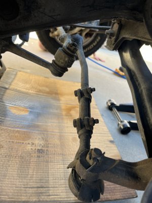

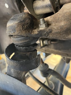

For the time being, we have ordered a front suspension kit form Kanter as the ball joints are pretty much toast on this car. Still debating on installing power steering on this car. My daughter is cleaning and sanding the engine bay so that we can paint it before installing the engine.
