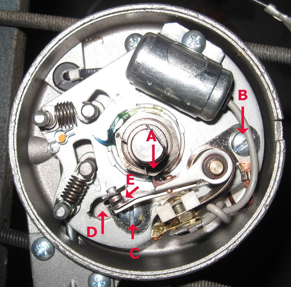

You may not need this but just in case, this is how you set the points: Photo Guide
1: Crank the motor until the Point Arm is on high point of cam lobe A
2: Loosen screw B and C just enough so a screwdriver in D can adjust without a lot of force.
3: Using screwdriver at D adjust point gap at E to .024 to .026. (.025)
4: Tighten B
5: Tighten C
6: Recheck gap at E.
Tightening B and C will have a tendency to change your point setting.
Keep the screwdriver in place as you tighten them..
Note: in the picture I didn’t quite make it on the high point.
The point arm MUST be on the tip or high point of lobe.
