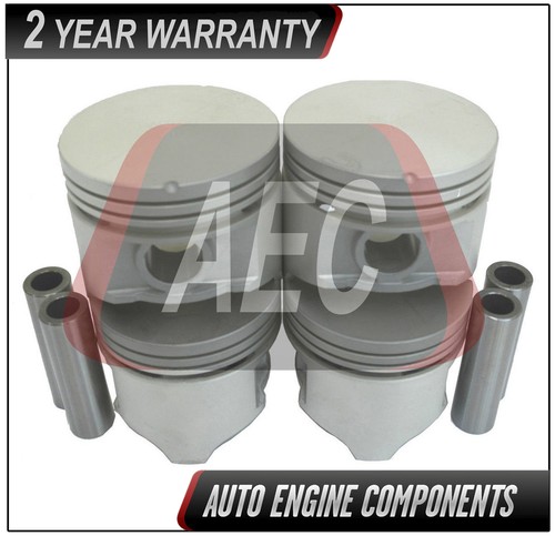

All Small Six Flat Pistons for 200 bored 3.710 (30 over)
Pistons for the 2.3L OHV 4cyl Ford Tempo/Mercury Topaz (1984-94) are flattop with the same compression height (CH) as the 200/250 6 cyl.
The piston rings will also work. Here is an eBay auction for a set of 4, 30 over. You will have to buy 2 sets to get six.
