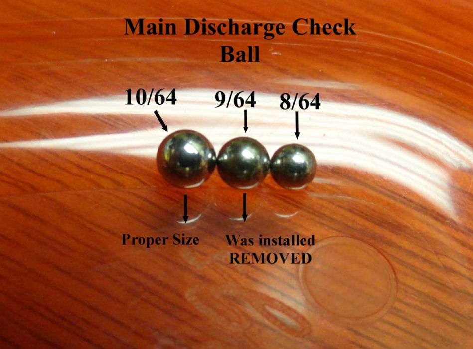

Oh yeah while I'm at have you checked your balls yet?

Just checked the ball and it looks like it's a 9/64.
