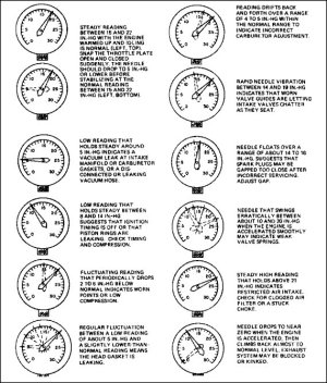

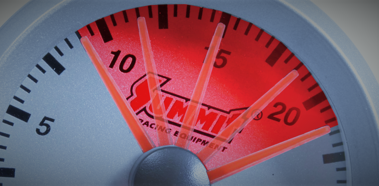

Have you checked with a vacuum guage .
can troubleshoot a lot of problems ieburnt,sticky leaking valves etc
Quick Tech: How to Read a Vacuum Gauge to Pinpoint Engine Problems
This article is packed with pictures to help you use a vacuum gauge and read the results to troubleshoot engine problems.
