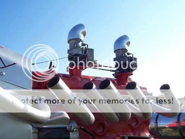

Heres a link to some pics of a ultraflow manifold fitted
