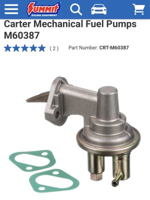

Order a carter pump from rock auto for $20.
Same problem. No fuel getting to carb.
