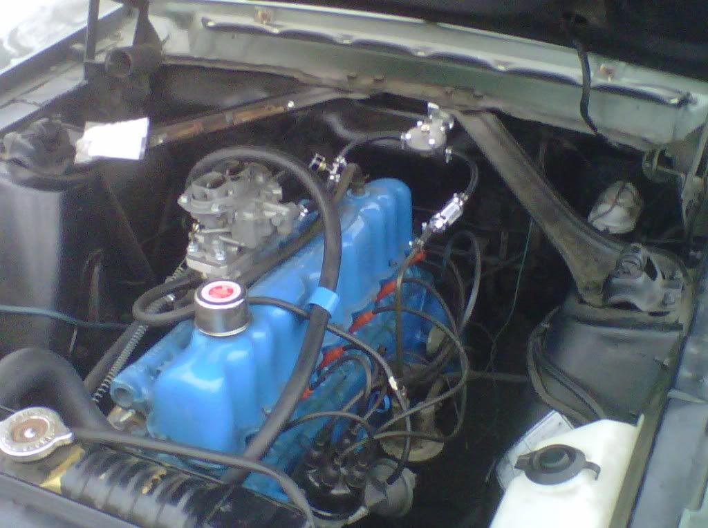

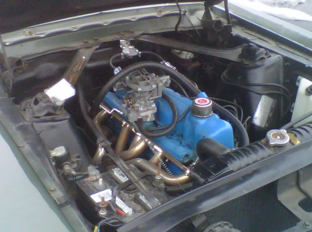

Thanks guys. I actually feel really dumb saying this but she was outta fuel :oops: . I got her out on the road today with fuel in the tank and she ran really well. She pulls alot harder than when I had the autolite on her. Not sure if it is jetted 100 % right or not but at idle she smells rich. No pinging under hard acceleration so i guess she is close. The car now shifts at 45 to 47 mph first to second at around 4800 rpm according to my tach :D . Here r a few pics of the final install. Excuse my dirty engine bay it needs a bath bad under there mostly dust from sitting.

Holy cow, you weren't kidding about our cars being similar. Its like looking at my own engine compartment.
So are you running a fuel pressure regulator out of the stock fuel pump or what? Like what is that thing on the firewall. The whole arrangement looks really shart, by the way. I have been thinking of doing something like this and I don't want to starve out the 2bbl.
Wow, that regulator and FP gauge are almost exactly where I put mine in the 'chero.
Great minds think alike I guess.

Ludwig yes I am using the stock pump with the a redline regulator. I bent a 90' bend on it then went to the rubber fuel line. If my car is starving for fuel you wouldnt know it the way she is runnin. Way better than with my 1100 which is probably 7-8 yr old pony carb. Even with them helping the old autolite out she still didnt run this good. The flat spots are pretty much gone.
Phantom yeah I guess great minds do think alike however I dnt feel like one lol. I wanted to center the reg up on the valve cover buy I am tryin not to do anything to my car that cant be reversed and make the car bone stock again within a few hours. Someday I may decide to go back but highly unlikely. Anyway the export brace bolt seemed great to use. I did take and put a 1in drop into the bracket "Z" shaped I am one of the lucky few with a sheet metal brake in their garage. I thought that the reg may be too close to the hood may be different on your chero idk. Good luck with it and let us know how you like the 38 I have a feelin that the 32/36 may just be a stepping stone to the 38 for me.
