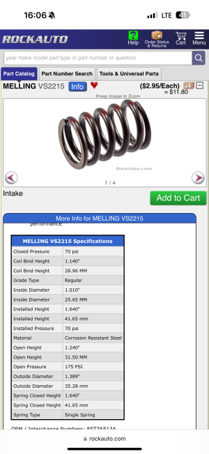

And just to be sure before I order anything else, these springs will work fine correct? Also they were sold out of my $10 injectors so I need to find another good deal. IMG_0293.png

The Melling VS2215 is the correct valve spring and will work on the exhaust valve with the intake retainer and .050" up locks.
Yes, I would replace all 12 springs with the new Melling springs.
You will have to make sure that the Melling spring has an installed height of no less than 1.650"

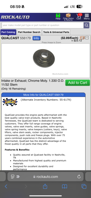

Will these retainers from Rock Auto work? They’re listed as being for intake and exhaust and the only ones available. I ordered the keepers you posted but the website for the retainers wants $21 for shipping which I think is a little outrageous for 6 spring retainers that will fit in a $6 flat rate envelope.
Yes, they are the same retainers as the ones from Goodson.
