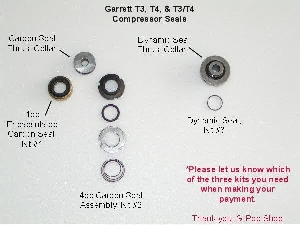

Like said before, it is an easy rebuild, just make sure you get the right seal. There are three for the T3.

So doing that again with new parts will be a breeze. How do I know which seal I need?

The three seals are kind of different in appearance, they are not too hard to tell apart:
That ought to help you.
Kirk
ps. click to the full size pic or the names of the seals will be hard to read.
8)

Bort62":2bwi8f8w said:
Ahh okay - thats for the compressor seal?
I've got the dynamic type.
Where did you get your kit?
I believe it was ebay, purchased from "anythingturbo" and it was American made parts. They say do not get the china made parts. Total w/ shipping was @ $59.00.
