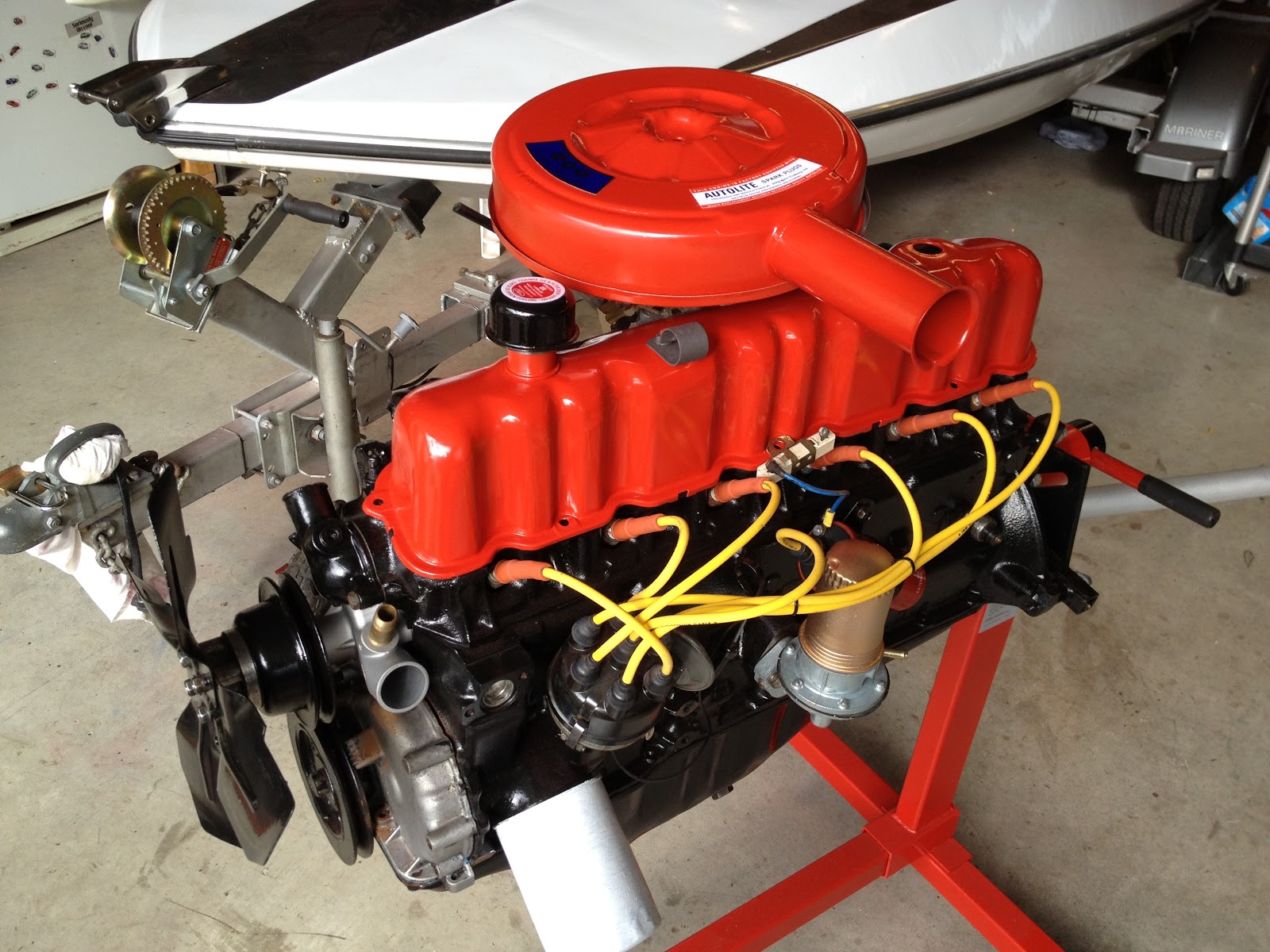

I have a rookie question for you all. How do you loosen the distributor to adjust the timing. I’ve seen a lot of videos on how to set the timing but I don’t know how to loosen the distributor so I can turn it. I have a 200 in-line six with stock distributor and carburetor

There will be a distribtor hold down with 1 bolt were the distributor center shaft flange goes down into the engine block usually you only need to loosen that bolt a little bit until the distribtor will turn. To see the hold down and its locking bolt you need to look under the distribtor cap / wide part of the distribtor body to the center shaft. Picture of a 1965 Ford 200 Six engine assembled showing the stock distributor installed. http://1.bp.blogspot.com/-4yUKrlTv540/T69874TcRxI/AAAAAAAAAOc/5-q_MNg-Tys/s1600/IMG_1881.JPG
