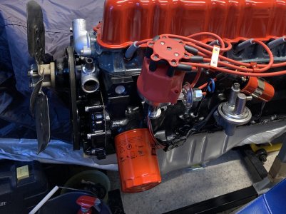

200ci Crank pulley too far in
This applies only to 200ci

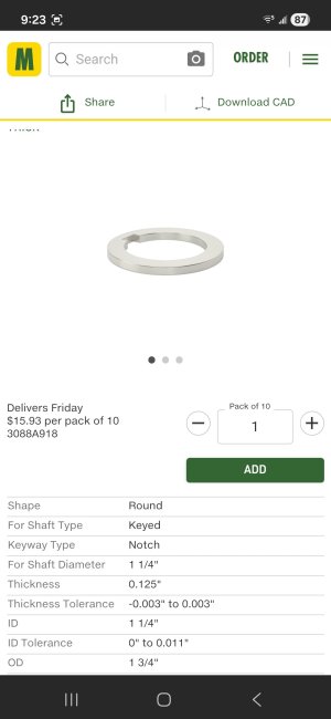

You have to use the big thick washer. When the damper is tight against the stock sprocket, the end of the crank is close to where the washer the sits, it almost bottoms out. You need a spacer to make it right because of the thinner new roller chain sprocket.
