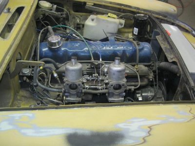

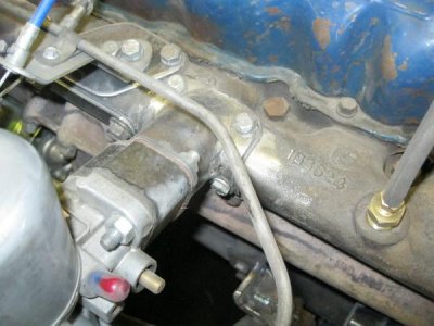

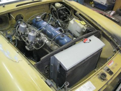

And I'll leave you with an example of what I'm talking about. A guy in his garage with an idea to improve carburetion on his 200" six in an MGB
