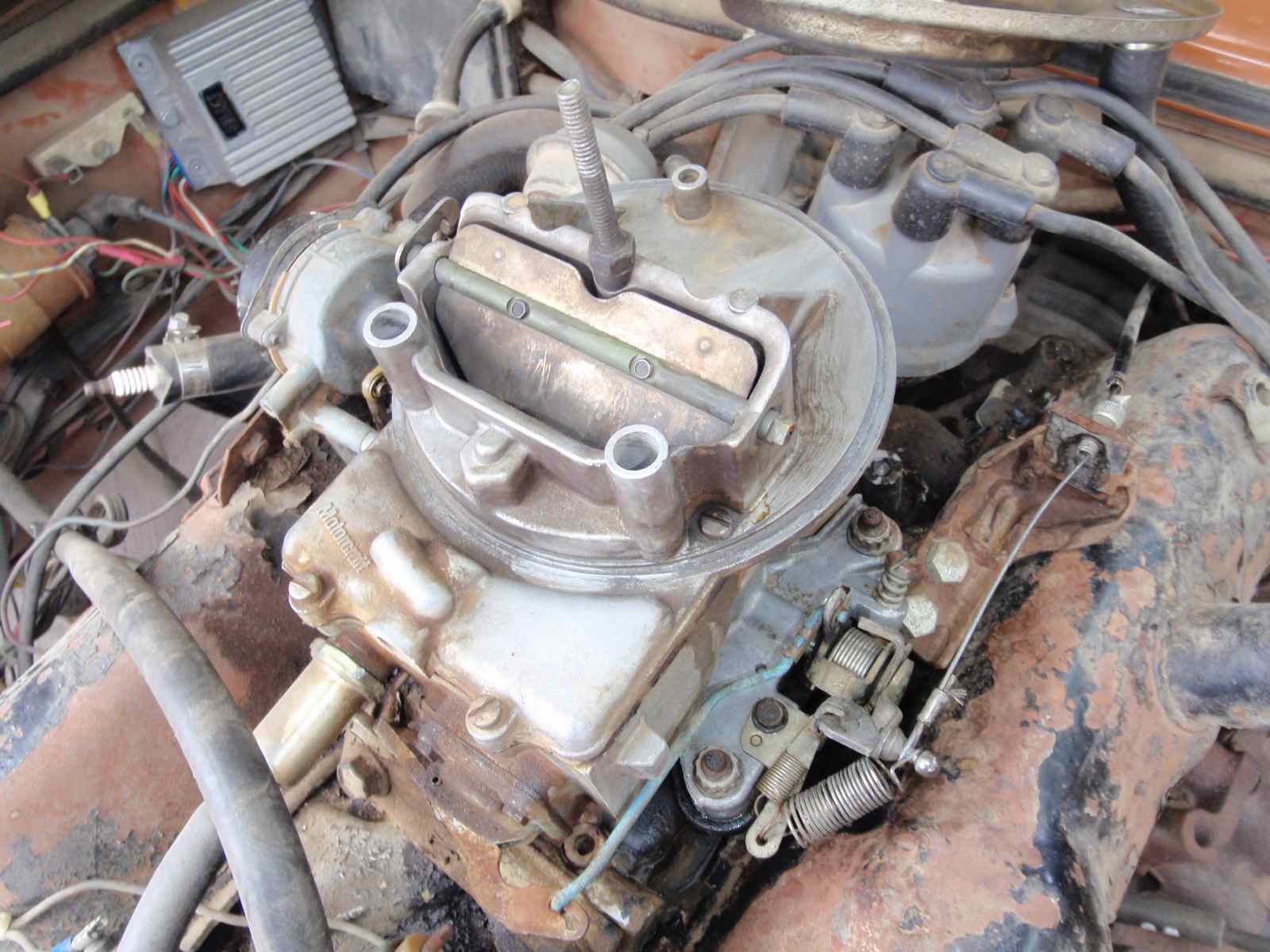

When carbs, especially bigger ones, fail to become responsive to mixture adjustment, its often because they are mounted the wrong way, and don't have the first 2 inches from the venturis un blocked for air flow.
Conventional thought in Australia is that the float bowl should face forward to the radiator. In a racing car or drag racing situation, it presents less problems. Its technically a problem because 2-bbl Holley 2300 sieris carbs, Autolite 2100's and Motorcraft 2150's have very poor air fuel distribution under idle verses wide open throttle.
Conventional thought US style is to have the float bowl pointing to the passenger side spring tower.
This is a problem especially with the small sixes offset ports which have ports for cylinders 3 and 4 widely spaced where gasoline cannot flow well.
The best options are to remount the carb float bowl into the rocker.

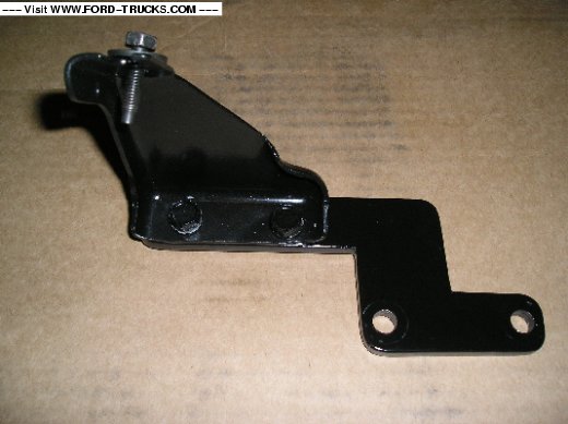

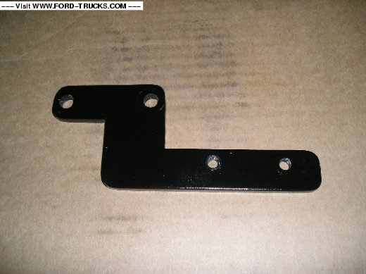

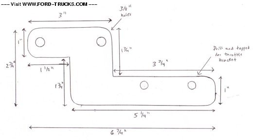

EFI 5.0 f truck cable is very cheep and very good and very long. 42.5" long F-250 accelerator cable is even better.
Copy the Offy C braket, and sling it under your alloy 4 hole adaptor.
care of
viewtopic.php?t=46640

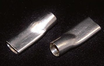

If you use jet extenders, you can use the later center hanger float bowl with Holleys
musclecardiy.com":2d8aju3h said:
These AED jet extensions have oval-shaped ends, which can be used without cutouts in the float
http://www.musclecardiy.com/performance ... ems-guide/

The common little European 1600 cc OHC engines ran the huge 195 cfm at 1.5" Hg (275 cfm at 3 "Hg) 32/36 Weber with a narrow lobe center cam and 55 cubes per square inch of carburation. That relationship copied to a proper open runner log head mod means a big 2-bbl 500 cfm carb could have its venturi sizes taken up to 1.52 inches from thr 1.375" they have stock. Carb flow goes up disproptionately to about 700 cfm at 3"Hg.
The maximum venturi size in a stock 4412 500 cfm Holley with physical venturi inserts is 1.56" with 1.75" over size throttles.
These aren't too big even for a 250 cubic in line six.
The brilliant, unlimited # 4412 2300 series based aftermarket 890 cfm C&S 1.56" (40 mm ) 2-bbl carbs would make even more, but they are illegal in circle track.
There is even the Split Billet Dominator unlimited 2 barrel 2” with 1.69" (over 43 mm) venturi carbs for unrestricted V-8 2 barrel classes that outflows 890 cfm carb above for even more excellent power.

The factory experimental 2V 200 head from 1978. I say 78 because it has the early non 1980 casting exhaust and log head component arrangements.
Under the alloy 2-bbl Motorcraft adaptor is a 5.4 square inch area of removed iron, as cast for the Engineering team who did the dyno and emissions calibrations.
Strangely, the alloy adaptor which mounted the Motorcraft 2150 has just two 1.6875" holes, or 4.474 sq in of area under the carb. No inform 1+2 bbl coonection between each barrel.
Normal 2-bbl adaptors prior to all the later Holley Weber stuff were like this.
I'm pretty sure the carb postion, adaptor and details in the XE head would have differed in this manner.
As far as I can tell, this item was 100% correct on the EGR and casting variations planned, but the carb looks to be a stand in. Everything else has Fords enginnering numbers etched in.
All the other stuff for the 1978 onwards engines was tending towards feedback carbs.
I'd love to know what the 1978 XE 200 engines 2-bbl test carb was....
