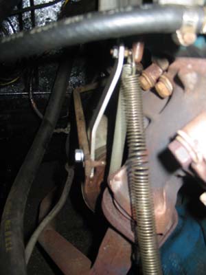

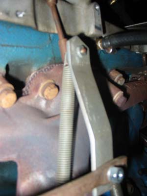

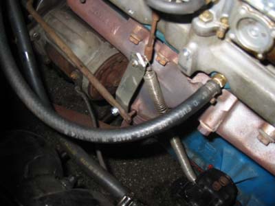

Here they are...hopefully they make sense.
From the Top:
From the Front:
From the rear:
While it doesn't show it in the pictures (since I went back to only 1 carb), the bend is necessary to clear the Offy linkages. Basically, you need to bend the rod out about an inch, and then make it so the linkage you make makes up for the inch and clears the linkages for the offy. Good luck.
