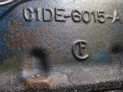

I don’t know the head code. The dealer sent me a couple of pictures. One is the block code. I don’t know what the second one is, but it makes no sense for a head.

Well, something is mixed up here. The low-mount starter blocks are from late in the 200's production run, they cannot have a C1DE casting number, it should be an E1BE or maybe a D8DE, and all of them have the five core plug/seven main bearing castings. Sometimes those numbers are hard to read, they're rusty, dirty, and dinged up. It will be interesting to see what's there when the pics get posted.
Well, they don't get any clearer than that! I just don't understand how that could be a low-mount starter block.

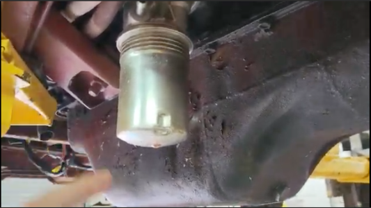

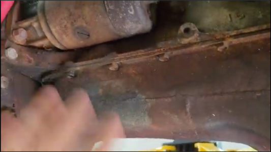

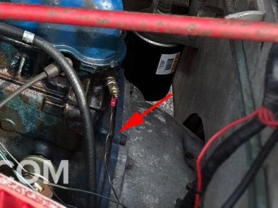

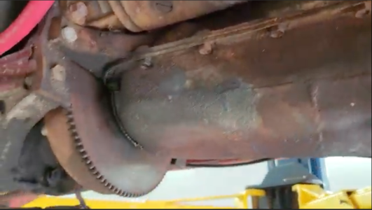

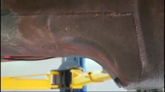

Here are some screen shots I took from the video the inspector sent kind of showing the starter location and some welded in “patches?” that might be significant. This car is a fabricated tribute to a 1930’s race car. It has a fiberglass body, wire wheels, etc. I guess anything might have been done to make it work. The photos are still up on the dealers’ website. There are not many engine photos and they are not close up. https://www.adventureclassiccars.com/vehicles/500/1931-alfa-romeo-p3-tribute .

Wow! Custom! Definitely not a low-mount starter or a big bell there, so by the number it's a 170. I gotta go check the dealer site...
I do not have much pre 66 knowledge so I can not say it is not a 200 but it do not think that it is. That is not a 200 big bell. It as a high mount small bell trans block. It looks like a adapter have been made to adapt the bellhousing to block and the flywheel looks odd. Maybe others have more info. As long as you know what you are getting and are happy with it is all that matters.
Cool car.
That's something odd ball. Don't see a reason for the welded up oil pan. Definitely not a 200 with that road draft tube. Weird coil. Some weird 5 speed, odd looking flywheel and clutch, odd looking teeth. When you said 5 speed, I was thinking a T5 conversion. This is a conversion to some other 5 speed, bell adapter on the back of the block to some non-Ford bell and trans. Alfa trans? No idea. She's oily! Has potential!

That is cool! For sure that's an old Ford six, by the # an early 170. Could have the original LOM distributor and SCV 1100 carb. With the small distributor drive in that block there aren't many alternatives to them. Some aftermarket coil there with an external resistor. Tight quarters in there, the oil filter has been relocated to the right rear of the block. I wish there was a pic of what they've done to the exhaust!
