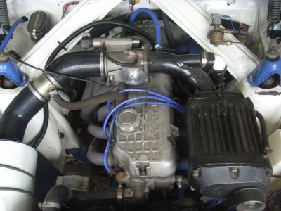

Just for your interest, if you havent seen mine here it is:-
This is a locally produced mixer, it operates more like a fixed venturi carby. You can see the rack and pinion type of mixture control, this is almost infinately tunable. I run a Bosch distributor and coil. Cold air to the intake is worthwhileRIMG0044.JPG
