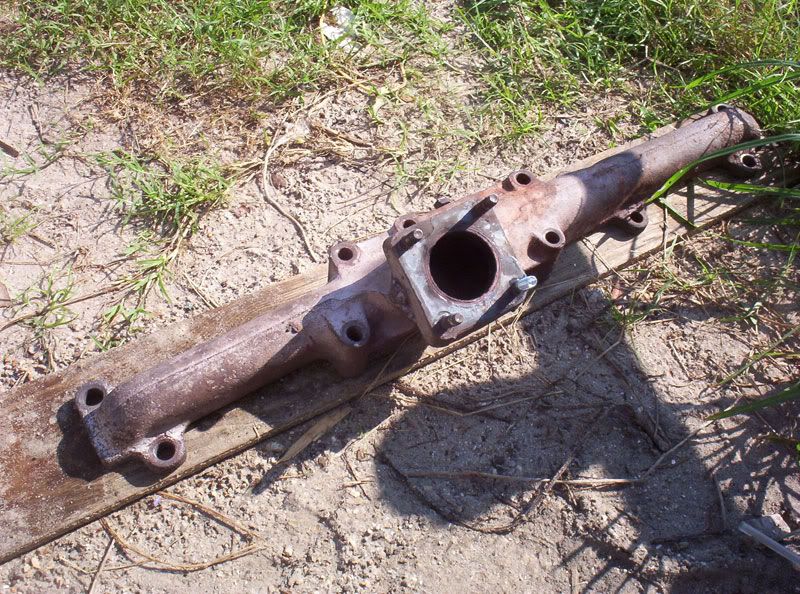

I made a log it was cheap and it was because that was what I could afford (I have $20 or so in it....mostly all scrape I had around)
if you can weld a setup like T-bones would work pretty good. buy an ebay flange and maybe a little work cutting up a mandral bend for a 90* bend and weld that to the stock manifold.
This is mine (T-Bone's)

:D Hi gravelrash and turbofairlane200.I have seen a lot of turbo setups over the years.OEM and homebrew.I have to say that the ones that you show have got to be the cleanest that I believe that I have ever seen.And I`m talking automotive,marine AND aviation.Great work.
Leo
It's a priceless feeling when things start to realize in a project. Good work !
