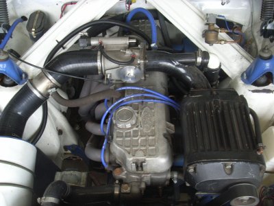

Ive messed around with turbo and supercharged, IMO unless a turbo setup is really well integrated into the engine, a supercharger works better on the street. The down low boost of a blower makes the car much more fun to drive. To that end i would advocate you look into one of the smaller rootes type blowers from some of the japanese models. Toyota used a 1.4litre displacement blower (SC14) see ebay, on one of their small cars, this running at the correct speed will give you a small amount of boost your asking for. for a 3.3litre six it would need to run about a 2:1 step up ratio. If you keep under 10psi (IMO) you will be OK with stock stuff. I dont know of the quality of the USA factory pistons, but here they stand up to some boost OK. I run up to 15psi on mine and so far OK, on LPG. The plumbing etc probably wouldnt be any more difficult than a turbo. Food for thought!
