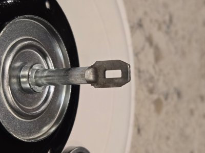

Removed electronic fuel pump installed mechanical pump....new tank....new lines, new filter.
New fuel pump from O'Reilly lasted under 40 miles and refused to push fuel.
Second pump from NAPA runs great but pushes oil from weep hole something fierce.
At idle I have good PCV flow proven at top of valve cover. Could I have pressure at 2-3,000 rpm?
I have 2,000 miles on a complete rebuild.
Thoughts? Besides sticking in a toothpick :)
This would be my third one. Now this one on the drive home the pivot pin walked out.
