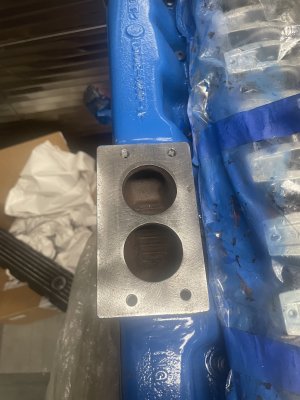

I don’t think it was ever discussed, but in first post you mentioned the intake was from a 70’s vintage. Is the intake separate from the head, or all cast into one piece??
The intake and the head are one piece.

And consider that the cfm on the Rochester is 280 and your stock carb may have been 185 cfm. But if your head is a 1970 it has a larger log than what was on the 1966 200 1240cc vs 1100cc. Changes like this will probably require tuning skills but old cars require that usually. Any corrections on this from anyone are appreciated.
Ok, currently doing more research on this, because this just opened up a rabbit hole that I need to go down.
So since the intake is larger, is it possible that the stock carb isn't powerful enough to pull enough air and fuel into it? I might have to upgrade to a better carb too.

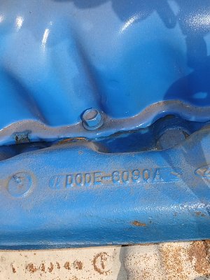

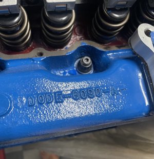

That the same head I have👍. I have been told it’s a good head for the 200’s. Mine has been modified for a 2 barrel. Allegedly it is a little bit of a rare head

The Rochester is a carb, a 2 barrel, not like your stock 1 barrel, and it flows more cfm which can increase performance when setup and tuned properly. This pdf is for fitting a 2 barrel Carter BBD to head like yours but the process for mounting will be similar for a small base Rochester 2 barrel. It is a rabbit hole haha.
The same one!! That's so cool. I'm trying to find more info on the head, looks like the codes say it came out of a falcon or a maverick if my research is right. Yours has a dash in between the 0 and the A, mine doesn't. Interesting 🤔🧐

If I remember right, the guy in California who did the modification said it was from a bronco. The dash /no dash is interesting, I would guess cast at a different place or a different guy making the tags that day 😎

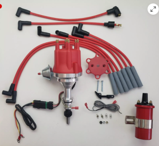

That all sounds good, I could check out the timing chain for sure. I did look at Bill's distributors and I was looking at the wiring but I got worried because it didn't look compatible with the coil I have. Guys on here suggested I can rewire it to make it work with my coil, but rewiring stuff is way too intimidating for me right now. I was looking around online and eventually found what I'm looking for, I'm going to pull the trigger on it tomorrow.
It is compatible with my year engine, has good reviews and a very detailed description, and it has a wire for a tach which is something I would really like to have. Made in America too! This will be fun.
Post a link to the site selling the product please. It will still require one rewire, it's not difficult, we'll help.
It will be an incompatibility problem if you have the LOM distributor, as explained above. When possible, remove the distributor cap and get as good a picture of the inside of it as possible, this will answer the question. "How so" is, the LOM uses a unique method of advance, all timing advance is done with vacuum only. This requires a matching carb with the vacuum passages set up for this distributor. Normal carb/ distributor combos, centrifugal weights in the distributor handle most of the advance, and the carb adds a part-throttle vacuum to increase advance in that operating parameter. The two designs are not compatible.
